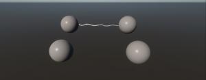

The project is large I couldn't upload, but I have taken a snapshot showing the issue, it shows 2 prefabs, the first is added before runtime and the other is instantiated at runtime, the first shows the rope mesh as intended but the second (the one instantiated at runtime) doesn't show the rope mesh, please advice

Posts: 6,537
425
10-12-2020, 12:55 PM
(This post was last modified: 10-12-2020, 12:56 PM by josemendez.)
(10-12-2020, 11:37 AM)amismail Wrote: Hi there,
Any help I am Stuck in this issue
I'm still unable to reproduce this. Tried in a variety of Unity versions, instantiating both at runtime and from editor, but it works perfectly for me. The rope prefab is simulated and rendered fine.
Just a sanity check: you're instantiating the rope under a solver component, right? If you are instantiating it anywhere else in the scene, simulation and rendering won't be updated. It is required for all actors to have a parent solver as explained in the manual:
http://obi.virtualmethodstudio.com/tutor...cture.html
http://obi.virtualmethodstudio.com/tutor...ctors.html
