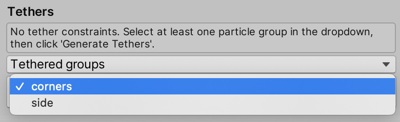

1) In the cloth blueprint editor, you'll find tether generation tools right below particle groups.
2) Select a particle group from the dropdown to tether all particles in the cloth to the particles in the group.
3) Click "Generate Tethers" to generate the tether constraints.

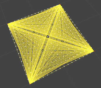

Current tether constraints will show up as yellow lines in the viewport, if tether rendering is enabled in the blueprint render settings.
