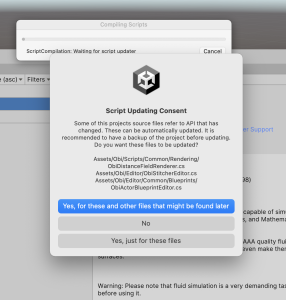

I'm using Unity 2022.3.32f1 and a new empty 3D project (built-in render pipeline). I import Obi Fluid 6.5.4 using the project manager and get the following update warnings:
I have to choose 'yes' to stop this warning being shown repeatedly.

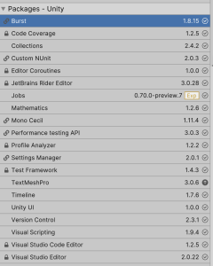

If I select a gameobject with an Obi Solver component, I can see the "The Burst backend depends on the following packages: " warning. I install the Mathematics, Collections and Jobs packages (using 'Add packages by git URL...' for com.unity.jobs) - Burst seems to already be in the package list:

(06-06-2024, 01:08 PM)Amael Wrote: I'm using Unity 2022.3.32f1 and a new empty 3D project (built-in render pipeline). I import Obi Fluid 6.5.4 using the project manager and get the following update warnings:
This is normal Unity behavior: when any of the existing scripts in your project use an API that has newer available alternatives, Unity will offer to automatically update the code to the newer API. This often works fine, so it doesn't matter whether you answer yes or no. In some rare occasions, Unity will botch the update and cause compilation errors after its automatic update attempt. However if you didn't get any, then it's fine.

(06-06-2024, 01:08 PM)Amael Wrote: If I select a gameobject with an Obi Solver component, I can see the "The Burst backend depends on the following packages: " warning. I install the Mathematics, Collections and Jobs packages (using 'Add packages by git URL...' for com.unity.jobs) - Burst seems to already be in the package list:
Yes, this is the expected behavior when any of the required packages for the Burst-based backend are missing. See:
http://obi.virtualmethodstudio.com/manua...kends.html
