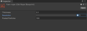

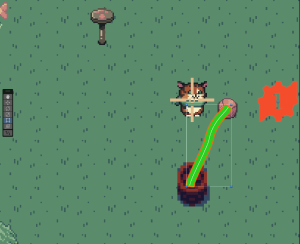

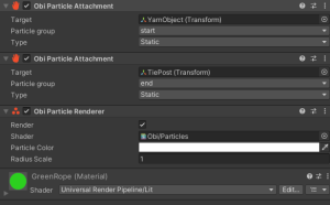

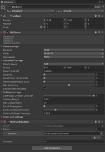

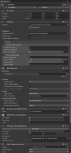

Sorry if this is a common problem, but I attempted to search the forum and didn't find anything. If anyone can help tell me what I'm doing wrong, or suggest something that might help fix this, I would greatly appreciate it. I've attached screenshots of the inspector for my various components.
Blueprint:
Solver:
Rope:
Scene View:

From your screenshot however, it looks like your game is 2D, is there any chance you're using URP's 2D renderer instead of the regular renderer? If that's the case, the built-in particle shader won't work as-is (since the 2D lighting system works in a completely different way to all other pipelines in Unity) and you must slightly modify it:
