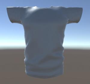

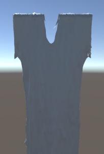

Here what I try
Before using unity-cloth
After using unity-cloth
You can see that the cloth is stretching to much. I try to decrease the max-distance to 0.1, but the cloth is simulated too bad just like before applying the unit-cloth effect.
Thank for your support,
Minh

Hi Minh,
To reduce stretching, you need to increase the amount of distance constraints iterations (in the ObiSolver component, the default is 3 but you can use 10 or more), or the amount of substeps if you're using version 3.3. See: http://obi.virtualmethodstudio.com/tutor...gence.html
Unfortunately you will not be able to achieve the same quality as Marvellous Designer. Performing such simulation in realtime in the CPU is impossible, even for MD (the video you sent is an offline sim/render, meaning that it took a long time to calculate it).
cheers,
