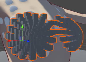

This screenshot shows the particles that are created:
[attachment=1726]

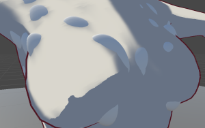

This screenshot shows the vertices that I have from the bones:

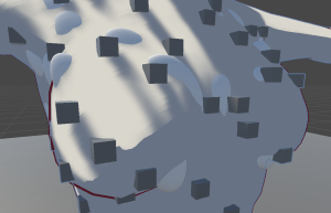

This is the vertices that have been found in the vertexToParticles list after all the optimization etc.
[attachment=1728]
