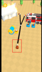

Help  Twitches
All attachments are dynamic
Plug moves via Vector3.MoveTowards
and sometimes there is such a moment. What is it connected with?
This also happens when there are only two plugs.
If you tell me how, I will attach a video
(05-07-2022, 03:17 AM)Sliast Wrote: All attachments are dynamic
Based on your screenshot, it seems like the rope is attached inside or very close to the object.
Make sure the rope isn't colliding with the object it is attached to. This problem along with the solution are described in the manual, see "attachments inside colliders": http://obi.virtualmethodstudio.com/manua...ments.html
If the problem persists, could you share a video of the issue? thanks!
