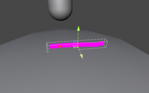

i want to know the box center position
(27-10-2021, 11:18 AM)wushuaiqi Wrote: i want to know the box center position
That's neither the solver's position, nor the rope's position. That's the rope's center of mass.
To calculate the center of mass of a deformable object, simply do a mass-weighted average of all particle's positions. You have sample code for this in the scripting section of the manual: http://obi.virtualmethodstudio.com/manua...icles.html
In your image, I guess the grey sphere is your "planet".
You won't be able to apply a single gravity value to the entire solver. The planet is small enough for different parts of the rope to be affected by different gravity vectors.
Calculating the rope's center of mass and somehow applying a single gravity value there (which is what I think you want) will not work. You must apply a different gravity vector to each individual particle. Does this make sense?
