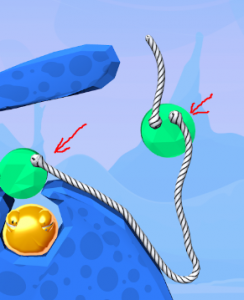

hi, I want to increase the size of the ends of my rope as shown below.

While this scales up the particle, the particle does not scale uniformly as shown in the image above.
My rope is rendered on a secondary camera that using a culling mask and camera clear flags set to "Depth Only", so that my ropes always render infront of all other objects.
goal is that I want the ends of the rope to be scaled up and face the camera always, so it looks clear and uniform. (As shown in the above image)
How can I achieve that effect?
I’m not sure I understand the question, the image shows 3 ends all uniformly scaled. Particles in a rope are always spherical.
For the same reason, it makes no sense to make a particle “face the camera”, since they’re radially symmetric: no matter how they’re facing, they will look the same.
Keep in mind that ropes do not model orientation, (unlike rods) so you can’t explicitly choose the orientation of a single particle.
