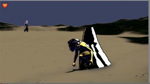

Sometimes this is seemingly harmless, and sometimes it results in, for example, my main character's gown being frozen in place:
If I manually disable and re-enable the cloth's `ObiLateFixedUpdater` component at runtime, the cloth simulates properly.

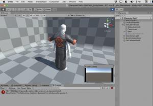

Thanks for the repro, Mattias - yes, this seems to be the same issue I'm seeing.
In the Obi Cloth "CharacterCloth" sample scene, for example, I rotated the camera to face away from the character, and pressed play:
I was able to reproduce this issue. I'll fix it asap and provide a patch. Thanks to you both for reporting it!
