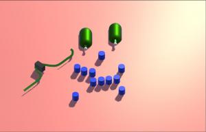

Hi ! I am working on a project and using ObiRope. I have problem with detecting collision with particles. I read documents and tried to use them as best as I can.
I need to know which particle collided with a object that has specific layer. And I want to tear the rope at collided particles. Here is some screenshots for explaining it better. At right (teared rope) image behaviour acts like I want. But after I spawn new ropes it doesn't work. When I am Debug.Log the shown indexes are beyond existing particle count (I may be wrong in here.).
