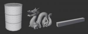

(01-06-2021, 04:16 PM)Nyphur Wrote: Look how regularly spaced all the vertices are on these models, they're designed to work well with Obi.
They're designed for good deformation, be it using Obi or otherwise (skeletal skinning, procedural shape modifiers, blend shapes, or any other kind of deformation).
(01-06-2021, 04:16 PM)Nyphur Wrote: The problem is that real game assets aren't usually built like this, they're optimised and vertex density varies from one part of the model to another.
Real game assets that are intended to deform *are* built like this, simply because it's impossible to deform them otherwise. Models are made of triangles and it's mathematically impossible to bend a single triangle, so you need many. Once you want part of a model to deform in any meaningful way you need to add more triangles and hence, more vertices.
This is why game characters have more edge loops & vertices around joints (shoulders, elbows, knees, etc): so that they can be deformed properly by the skeleton:
If you had to deform any part of the character and not just the joints, you'd place edge loops everywhere and end up with homogeneous vertex density. Of course, most pre-made game assets you can find online aren't designed with deformation in mind: vertex distribution is "optimized" for visuals only.
(01-06-2021, 04:16 PM)Nyphur Wrote: As a result, the surface blueprints generated can have big gaps and the particles won't be able to connect properly using distance. That's why I was thinking that either intermediate particles need to be created or there needs to be a much better way of connecting particles to neighbours than using distance.
What's the point of adding and connecting more particles, if there's no vertices to be deformed by them? Take for instance Unity's built-in capsule shape:
Captura de pantalla 2021-06-02 a las 9.16.52.png (Size: 61.02 KB / Downloads: 20)
If you wanted to bend it 90º (I used Blender's deform modifier here) this is what you'd get:
Captura de pantalla 2021-06-02 a las 9.17.12.png (Size: 87.45 KB / Downloads: 20)
Doesn't look good, does it?. No matter how many particles you add in the mid section of the capsule, the result will look terrible since the mesh doesn't have enough vertices in that region. This mesh isn't supposed to be deformed as-is. If you want decent deformation by any means, you need to add vertices in there:
Captura de pantalla 2021-06-02 a las 9.17.48.png (Size: 93.61 KB / Downloads: 20)
For a model to be deformable, it has to have proper topology and enough vertex density. This not exclusive to Obi but just how geometry works: having more deformation targets -particles in Obi, but also lattice points, skeleton bones, clusters, spline control points, etc... in other deformation systems- than vertices in a mesh doesn't make sense in any case than I can think of. You usually want the opposite: less bones than vertices, less lattice points than vertices, less particles than vertices, etc.
It's like trying to get a good flag simulation from a single quad: you simply can't, unless you add more vertices.

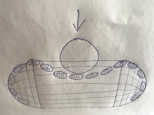

OK, this is where I think the misunderstanding is. This example with the capsule actually is what I'm trying to achieve. The capsule example is pretty extreme since it has that huge relative gap between vertices and that 90 degree deformation. Most models won't be as bad as this, and not every use case necessarily needs a smooth deformable softbody.
Say we use a regular Unity capsule mesh like your example. If we set the cluster radius correctly so that the top area connects together well and the bottom area connects together well, the top and bottom will not be connected to each other. You effectively get two separate softbodies flopping on the floor with triangles trailing between them. But if you set the Cluster Radius high enough to connect the top to the bottom, the entire top area and bottom area will be way over-connected.
What I want is to be able to connect the top and bottom parts somehow without overconnecting everything else. That's why I suggested maybe a new way of connecting particles (other than cluster radius) or maybe generating intermediary particles to get around that problem. I know that the end result wouldn't look good if we're deforming it as you showed in your helpful example. But wouldn't it still do a decent job of impact deformation like your barrel example? And wouldn't the particles still collide with other softbodies even if they aren't influencing vertices in the mesh?

In that case, you'd have soft caps (bottom and top of the capsule) and a completely rigid mid-section that doesn't react to collisions (since there's no particles to collide). Colliders and other softbodies would pass right trough the mid part of the capsule.
(11-06-2021, 12:31 AM)Nyphur Wrote: maybe generating intermediary particles to get around that problem. I know that the end result wouldn't look good if we're deforming it as you showed in your helpful example. But wouldn't it still do a decent job of impact deformation like your barrel example?
Generating intermediary particles is ok, but that you can already do by using a subdivided mesh to generate the blueprint and skinning the original, unsubdivided mesh to it. However if you already have a subdivided mesh for particle generation, what's the point in using the original, unsubdivided mesh for skinning? (which will look worse). You usually do it the other way around: use a low-quality mesh to generate particles, then skin a high-quality mesh to it.
(11-06-2021, 12:31 AM)Nyphur Wrote: To come back to this point, maybe I'm misunderstanding the tool but doesn't Obi Softbody simulate collision and stuff too? The idea with adding those extra vertices isn't to improve the deformation (because obviously it won't, there are no more vertices to deform). It's to fill in the gaps so we have regularly spaced particles, both so we can connect the particles together easily so that other softbodies on the solver can collide/interact with it well. Is that the wrong way to do this? [...]wouldn't it still do a decent job of impact deformation like your barrel example?
Yes, having denser particle sampling in regions with no/few vertices would allow for collision detection. However collisions *always* cause deformation since they push particles around (impact deformation, as you describe it), so objects would clip trough and look wrong: colliders & other softbodies would sink into the mesh when colliding, as the particles deform but the mesh doesn't. Sketched it for you (the sphere pushing from above would be a collider, and I've only drawn the relevant particles):
Only case where deformation would not happen as result of collision would be a completely rigid softbody. But if you have a completely rigid softbody, you might as well be using a rigidbody which is a lot cheaper to simulate and will look much better.
Softbody = deformable body = you need vertices for good deformation. What makes sense in pretty much all cases (and what all physics engines do) is to have a high-quality mesh for visuals and a low-quality, simplified physics representation of it, not the other way around. Thats' why blueprints start with one particle per vertex -max quality-, and can only go down from there -proggressively lower quality-.
If you *really* wanted this for some reason (w/ collision clipping and derpy deformation), it would be possible to do it by:
