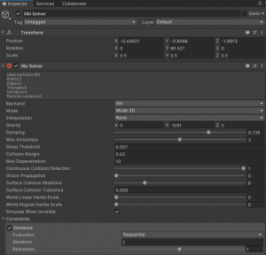

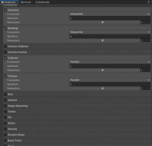

Most other settings in your screenshots make no sense either:
- In the solver, distance constraints relaxation is set to 0.1. That means that distance constraints will only have 10% of their full effect. However you're using 50 iterations on them, so this is basically just burning performance: you spend a lot of time enforcing constraints that are as good as deactivated, and the resulting rope will be extremely stretchy and noodle-like. Set the relaxation to 1 (100%) so that distance constraints can be fully enforced, and then you'll only need a few (3-4) iterations. From the manual: http://obi.virtualmethodstudio.com/tutor...olver.html
Quote:Relaxation Factor
Values lower than 1 will only partially enforce constraints. For instance, with a relaxation factor of 0.25 constraints will only have a 25% of their normal effect.
- Your bend compliance is set to 0.54 m/N. That's a lot. The result is that the rope will be allowed to bend so much that you won't notice any difference between using bend constraints or not, so this is also just burning performance for no good reason. Either set compliance to a smaller value (eg 0.0001) or deactivate the constraints entirely if you're not using them.
- Your rope is at maximum resolution, yet you're using surface collisions. Again, this will just make the simulation extremely costly for no reason. Either reduce your resolution (0.25-0.5 is a good range) or disable surface collisions entirely. See the "tips" section in: http://obi.virtualmethodstudio.com/tutor...sions.html

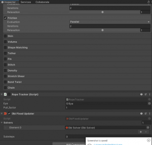

I changed the values as you pointed out. The length of the rope is good now. And the stretching for average hand movement speed is gone. But I wasn't able to fix the collision issue.

I can't really spot any more issues with your setup, but collisions should be way more robust than they are now. There must be a problem somewhere else. What's your fixed timestep set to? (Project Settings->Time->Fixed timestep)
