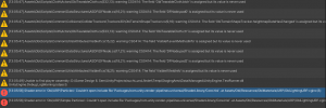

Maybe the errors might give some inisght >.<

(10-03-2021, 01:03 PM)Azraael Wrote: Maybe the errors might give some inisght >.<
If you're not using URP, the included URP shaders can/should be removed. Either way they won't affect the simulation.
