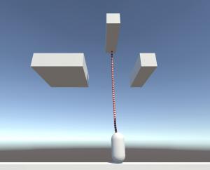

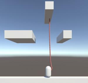

I come back to this thread and try to give better examples. See images.
With tilted camera hook attaches to different points in z-depth if I click lower or higher (I don't click the object..).
When camera is not tilted hook attaches always to same z-depth.
