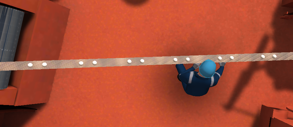

I havn't had time to test it yet. But regarding the broken ropes, it seems to happen consistently when I duplicate a rope, duplicate the blueprint, and then apply the new blueprint to the rope. I lose control over the rope like so:
If I then revert the blueprint to the original one that the rope was cloned with, it updates to the changed blueprint but is still broken with the particle controls:

(29-01-2020, 09:56 AM)TheMunk Wrote: I havn't had time to test it yet. But regarding the broken ropes, it seems to happen consistently when I duplicate a rope, duplicate the blueprint, and then apply the new blueprint to the rope. I lose control over the rope like so:
Not able to reproduce this either. What I did:
- Duplicate the rope.
- Duplicate the blueprint and assign it to the duplicate rope.
- Edit the duplicate rope (and/or the original one). Both work correctly.
Do you get any console errors while doing this?
