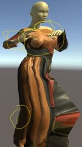

I am unable to fix mesh intersection issue on runtime as you can see below in those screenshot i have uploaded
I just created custom collider on character to make it right but it doesn't work at all and not getting good physics simulation as well.

I am uploading some screenshot of collider you can get better idea what's happening here!!

Yeah! i just removed proxy now it's better but still getting mesh intersection and after using skin constraint i am not getting good simulation like character cloth example had.
as you can see below Screenshot i have attached "Bad Simulation, Mesh Intersection".
-Without skin constraints i am getting simulation like smooth but the cloth fall down after a while, Basically collider isn't working on cloth that character worn as you can see below Screenshot i have attached "Without Skin Constraints and 02".
-Would you like to suggest me what solver and obi cloth setting should i use, currently i am using these setting as you can see in below screenshot:-" SolverSetting".
