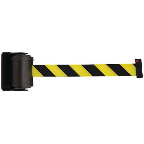

Hey, I would like to, in my VR app, make a barrier belt, like in cinemas at the box office or airports to cordon off aisles.
[Image: AIG2730470.jpg]
