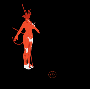

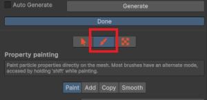

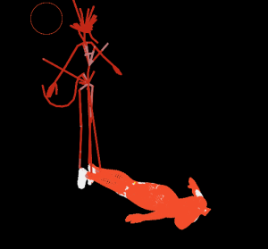

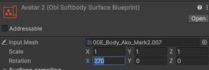

I'm reporting a bug. - twocomet - 17-10-2024 [attachment=2220] In the case of this mesh, it is rotated on the floor from the beginning. [attachment=2221] If you rotate it, it returns to normal. [attachment=2222] The selection function works fine. [attachment=2223] Now we go into painting mode to edit the mass. [attachment=2224] Painting can never be done on a standing area. Painting is only possible on empty spaces where they lie before being rotated. RE: I'm reporting a bug. - josemendez - 17-10-2024 Hi! Thanks for reporting this! could reproduce the issue, will share a patch as soon as possible. kind regards, RE: I'm reporting a bug. - josemendez - 17-10-2024 Open up ObiPaintBrushEditorTool.cs. At the very end of the file (near line 117) you'll find this method: Code: public override void OnSceneGUI(SceneView view)Modify it by adding the following two lines, like so: Code: public override void OnSceneGUI(SceneView view)That should fix the problem. Let me know if I can be of further help, kind regards |
