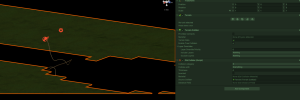

Hmm, I'm on 7.0.2 and it doesn't seem to work for me. I thought the issue was related to me changing the hole data at runtime but even if I paint a hole in the terrain before starting the scene, the rope will not pass through. Is there anything particular I need to do? I just have a terrain with an obi collider - am I missing something? See the attached image for reference:
EDIT: Ok I sort of figured it out - in my test scene, I had the heightmap flattened down to zero. I'm looking at the logic in ObiHeightFieldContainer.cs where it reads the hole data but I'm not exactly sure how it explains what I was seeing before. I can work around the issue in practice, but the "invisible floor" at terrain height 0 is unexpected - not sure if it would be considered a bug.

(04-09-2024, 08:34 PM)btduser Wrote: Hmm, I'm on 7.0.2 and it doesn't seem to work for me. I thought the issue was related to me changing the hole data at runtime but even if I paint a hole in the terrain before starting the scene, the rope will not pass through. Is there anything particular I need to do? I just have a terrain with an obi collider - am I missing something? See the attached image for reference:
Terrain holes are encoded as the sign of the heightmap values: positive height means solid terrain, negative height means a hole. According to IEEE floating point standard, -0 is equal to 0, which means a hole at height zero is actually considered solid terrain (because -0 is not < 0). The alternative in this case would be to have -0 be less than 0, which would cause all terrain at height zero to be a hole - probably a worse option.
