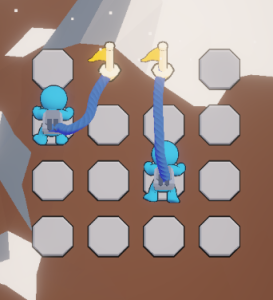

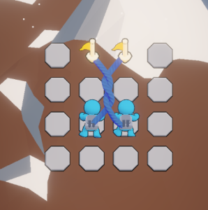

[attachment=2064][attachment=2065]
I have a similar setup as the above image,  How to know if the rope is not tangled anymore? like in the first image. I have enabled the surface collisions and tried with OnParticleCollision but it has not worked for me. can I ray cast from each particle of the rope a bit upward and check if it has collided with another rope? or is there any other simple workaround for this?
