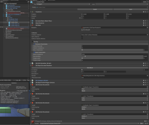

Rope Jittering/ Stuttering - Nixon - 03-05-2024 Good Day, thank you for your time! I am currently experiencing rope stuttering in my VR Game. I have made a small video demostration, where you can have a look at how it is experiecned: https://drive.google.com/uc?id=171SoEWafSJkIdzB-YV9xUPN28-F6vGLd&export=download Then after watching the video, heres some screenshots from the Components! I have attatched two screenshots to this, one is the Solver Inspector + Hierarchy and one is one of the Ropes Inspector Again, thank you so much in advance! Best, Nixon
RE: Rope Jittering/ Stuttering - josemendez - 03-05-2024 Hi Nixon, The link to the video results in "error 403: Forbidden", seems like I don't have access to it. There's no screenshots attached to your post either. kind regards, RE: Rope Jittering/ Stuttering - Nixon - 03-05-2024 Damn, sorry. I forgot to click on "Add Attatchment" after putting them in ![attachment=2058] [attachment=2059] And the mp4: https://drive.google.com/file/d/171SoEWafSJkIdzB-YV9xUPN28-F6vGLd/view?usp=sharing Sorry for the inconvinience! Best, Nixon
RE: Rope Jittering/ Stuttering - josemendez - 06-05-2024 Hi, You're using velocity tracking to interact with objects in your scene, but using static attachments to attach the ropes to them. As a result, there will be a delay between the attachments and the interactable. Either use dynamic attachments, or set your interactable's movement type to kinematic. kind regards, |
