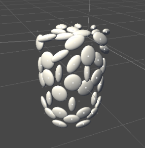

I've got a sample Softbody project, a barrel blueprint (for instance). The particles look just normal.
[attachment=1927]

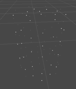

And then there's another project, and partcles don't render at all - just white dots.
[attachment=1926]
They became missing at some point, can't even figure out when. Please give me a hint how to fix it.

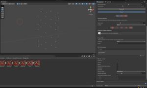

The particle rendering is enabled:
[attachment=1928]

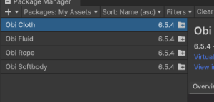

OBI versions:
[attachment=1929]
