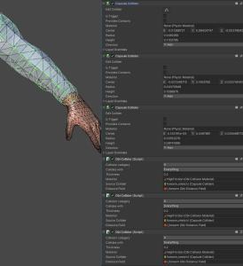

I'm aware that the Obi collider only works if the mesh, or in this case, the joint has and native collider, right? So I use capsule colliders in each joint and create an Obi collider:
[attachment=1875]
With this setup the dynamics works and the mesh collides with movement, but, as the manual says, the capsule colliders have low resolution, so I create a distance field in this way:
