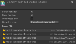

When I create a new project with "3D(URP)" and import Obi Fluid, I get an error in the following Shader inspector.
If I build on Windows Intel 64bit environment in this state, the fluid that was normally displayed in Editor will not be rendered.
Obi/Resources/ObiMaterials/URP/FluidShaderURP
Implicit truncation of vector type
Compiling Subshader: 0, Pass: FluidShader, Fragment program with <no keywords>.
Platform defines: SHADER_API_DESKTOP UNITY_ENABLE_DETAIL_NORMALMAP UNITY_ENABLE_REFLECTION_BUFFERS UNITY_LIGHTMAP_FULL_HDR UNITY_LIGHT_ PROBE_PROXY_VOLUME UNITY_PBS_USE_BRDF1 UNITY_SPECCUBE_BLENDING UNITY_SPECCUBE_BOX_PROJECTION UNITY_USE_DITHER_MASK_FOR_ALPHABLENDED_ SHADOWS
Disabled keywords: FLUID_FOAM FLUID_FOAM FLUID_LIGHTING FLUID_REFLECTION FLUID_REFRACTION SHADER_API_GLES30 UNITY_ASTC_NORMALMAP_ENCODING UNITY_COLORSPACE_GAMMA UNITY_FRAMEBUFFER_FETCH_AVAILABLE UNITY_HALF_PRECISION_FRAGMENT_SHADER_REGISTERS UNITY_HARDWARE_TIER1 UNITY_HARDWARE_TIER2 UNITY_HARDWARE_TIER3 UNITY_LIGHTMAP_DLDR_ENCODING UNITY_LIGHTMAP_RGBM_ENCODING UNITY_METAL_SHADOWS_USE_POINT_FILTERING unity_no_dxt5nm unity_no_full_standard_shader unity_no_screenspace_shadows unity_pbs_use_brdf2 unity_pbs_use_brdf3 unity_pretransform_to_display_orientation unity_unified_shader_prevention_model UNITY_VIRTUAL_TEXTURING _GLOSSYREFLECTIONS_OFF _MAIN_LIGHT_SHADOWS _MAIN_LIGHT_SHADOWS_CASCADE _RECEIVE_SHADOWS_OFF _SHADOWS_SOFT _SPECULARHIGHLIGHTS_OFF _SPECULAR_SETUP

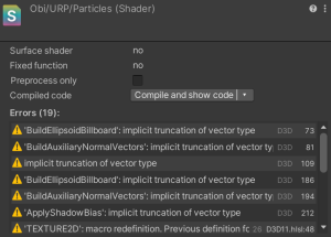

Obi/Resources/ObiMaterials/URP/ParticleShaderURP
'BuildAuxiliaryNormalVectors': implicit truncation of vector type
Compiling Subshader: 0, Pass: 0 0, Pass: ShadowCaster, Fragment program ShadowCaster, Fragment program with SHADOWS_DEPTH
Platform defines: SHADER_API_DEPTH SHADER_API_DESKTOP UNITY_ENABLE_DETAIL_NORMALMAP UNITY_ENABLE_REFLECTION_BUFFERS UNITY_LIGHTMAP_FULL_HDR UNITY_LIGHT_PROBE_PROXY_VOLUME UNITY_PASS_SHADOWCASTER UNITY_PBS_USE_BRDF1 UNITY_SPECCUBE_BLENDING UNITY_SPECCUBE_BOX_PROJECTION UNITY_USE_DITHER_MASK_FOR_ALPHABLENDED_SHADOWS
Disabled keywords:. SHADER_API_GLES30 SHADOWS_CUBE UNITY_ASTC_NORMALMAP_ENCODING UNITY_COLORSPACE_GAMMA UNITY_FRAMEBUFFER_FETCH_AVAILABLE UNITY_HALF_PRECISION_FRAGMENT_SHADER_REGISTERS UNITY_HARDWARE_TIER1 UNITY_HARDWARE_TIER2 UNITY_HARDWARE_TIER3 UNITY_LIGHTMAP_DLDR_ENCODING UNITY_LIGHTMAP_RGBM_ENCODING UNITY_METAL_SHADOWS_USE_POINT_FILTERING UNITY_NO_DXT5nm UNITY_NO_FULL_STANDARD_SHADER UNITY_NO_SCREENSPACE_SHADOWS unity_pbs_use_brdf2 unity_pbs_use_brdf3 unity_pretransform_to_display_orientation unity_unified_shader_precision_model unity_virtual_texturing

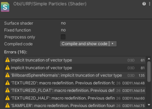

Obi/Resources/ObiMaterials/URP/SimpleParticleShaderURP
'BillboardSphereNormals': implicit truncation of vector type
Compiling Subshader: 0, Pass: 0 0, Pass: ShadowCaster, Vertex ShadowCaster, Vertex program with SHADOWS_DEPTH
Disabled keywords: SHADER_API_GLES30 SHADOWS_CUBE UNITY_ASTC_NORMALMAP_ENCODING UNITY_COLORSPACE_GAMMA UNITY_FRAMEBUFFER_FETCH_AVAILABLE UNITY_HALF_PRECISION_FRAGMENT_SHADER_REGISTERS UNITY_HARDWARE_TIER1 UNITY_HARDWARE_TIER2 UNITY_HARDWARE_TIER3 UNITY_LIGHTMAP_DLDR_ENCODING ENCODING UNITY_LIGHTMAP_RGBM_ENCODING UNITY_METAL_SHADOWS_USE_POINT_FILTERING UNITY_NO_DXT5nm UNITY_NO_FULL_STANDARD_SHADER SCREENSPACE_SHADOWS UNITY_PBS_USE_BRDF2 UNITY_PBS_USE_BRDF3 UNITY_PRETRANSFORM_TO_DISPLAY_ORIENTATION UNITY_UNIFIED_SHADER_PRECISION_ MODEL model unity_virtual_texturing

Implicit truncation warnings aren't a concern, they just mean the compiler will automatically convert a float4 to a float3 (or a float3 to a float2, etc) by ignoring the last component. This will raise a warning in some graphics APIs. As long as there are no errors, the shaders should work.
