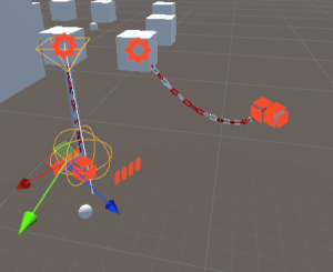

I'm working on a rope system to move objects, and I have something that is working. The problem is that, when I change the lenght of a rope (usually when it becomes smaller), the Particle Attachment seems to not be working... All my code to AddComponent works usually, but when the rope has been shorten, the ParticleAttachment is being added but the rope doesn't move, and the object attached becomes crazy...
Does anyone has a solution ? :/
Thanks in advance for your answers, and have a nice day !
(under, two screenshots to help to understand)
Edit : added a video to help understand (not eng native speaker sooo not easy for me..)
https://youtu.be/b2h1QB8CQEg

In the video it looks like the attachments are being added dynamically when the cube is close to or in contact with the rope. May you share the code you're using to do this?

Hello ! I've make a rope prefab, and in this prefab there's a Cube without mesh, triggered, and the rope has a Particle Attachment to this Cube on the particle End.
The script on the Cube is :
private void OnTriggerEnter(Collider other)
if (other.gameObject.layer == LayerMask.NameToLayer("Grabbable") && !HasTouch)
HasTouch = true;
ObiParticleAttachment attach = rope.AddComponent<ObiParticleAttachment>();
attach.target = other.transform;
attach.particleGroup = rope.GetComponent<ObiRope>().blueprint.groups[rope.GetComponent<ObiRope>().blueprint.groups.Count - 1];
attach.attachmentType = ObiParticleAttachment.AttachmentType.Dynamic;
GetComponentInParent<GrabbableLmts>().grabbableObject = other.gameObject;
Now that I'm looking at it, isn't it the "rope.GetComponent<ObiRope>().blueprint.groups[rope.GetComponent<ObiRope>().blueprint.groups.Count - 1];" that is a wrong way to do when I'm changing the lenght of the rope ?
Thank you for your time !
Okay I've tested and now I'm sure that it's the problem... It's like if I was attaching it to an inactive particle right ? Then, is it possible to detect if the particle is active ? Or maybe could I add a particle at the end of the rope, with its lenght parameter, at runtime...?
RE: Obi Rope attachment - parzi - 30-06-2023
Tryied to find a way to access the last one active with the ObiStructuralElement class (because it seems that you're doing that in the ChangeLenght function in ObiRopeCursor but can't find anything working Triste
