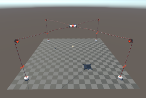

So I am controlling the position of an object attached to 4 cables (Scene shown below).
[attachment=1756]
When giving control to all the cable to move the robot. Sometimes the cables jitter continuously.
(check the video in the link below)
https://drive.google.com/file/d/139fZwr1qw8G0J2ZYvQP-ZL3oEqWSof7C/view?usp=sharing

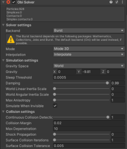

Obi Solver:
[attachment=1758]
[attachment=1759]
