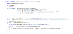

I am using obi soft body Teleport function but I am getting below exception. How can I solve that problem.
[attachment=1633]
[attachment=1635]

Which version of Obi are you using? line 206 in that code should read:
sc.batches[i].orientations[batchOffset + j] = rotOffset * sc.batches[i].orientations[batchOffset + j];
instead of
sc.batches[j].orientations[batchOffset + i] = rotOffset * sc.batches[i].orientations[batchOffset + j];
Notice the i and j variables in the left side of the = are swapped in the code you shared.

Thanks a lot for your quick answer.
