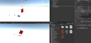

I am trying to make a softbody using OBI Softbody and use the OBI particle Attachment to hold the object in the same place from its corner, but when I am adding the Obi particle Attachment script, I am unable to select the Particle Group or change it to corners. I am not sure why Huh , some help would be really appreciated.  Tímido
RE: Obi particle Attachment - josemendez - 19-01-2023
(19-01-2023, 02:54 PM)ilyas_Gefeasoft Wrote: Hello,
Does your softbody blueprint have any particle groups in it? You create these from the blueprint editor, by selecting the particles you want to be part of the group and clicking the "+" sign in the particle groups list. See:
http://obi.virtualmethodstudio.com/manual/6.3/softbodysetup.html
RE: Obi particle Attachment - ilyas_Gefeasoft - 19-01-2023
(19-01-2023, 03:18 PM)josemendez Wrote: Hi!
Thank you for your assistance. I followed the guidance and it worked.
