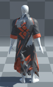

Character Cloth is broken in sample scene - webmagic - 28-12-2022 Hi , I just purchased the Obi cloth and installed Burst/Mathematcis/Colletcions... and everything is all right except the Characters Cloth. When I open the scene, it looks OK but when I run the scene, the cloth is broken as attached screen shot. using unity 2021.3.3f1 Thanks RE: Character Cloth is broken in sample scene - josemendez - 28-12-2022 (28-12-2022, 08:12 AM)webmagic Wrote: Hi , Hi, This is a known issue with Unity 2021.1 and up. See the following thread: http://obi.virtualmethodstudio.com/forum...-3331.html Long story short, Unity 2021.1 changed the way order in which vertices appear in certain meshes compared to Unity 2020.X and older versions. So, cloth blueprints generated for meshes in versions older than 2021.1 have their vertex order garbled up, because the order in which vertices are serialized for the cloth and the order in which Unity draws them doesn't match. This only happens for meshes imported from older Unity versions, such as the ones used in some sample scenes (they were created in Unity 2019.4). It will not affect any cloth that you create in 2021.1. Unfortunately there's nothing we can do to fix this ourselves, since it would mean raising the minimal compatible version of the asset to at least 2021.1 just for the sake of the sample scenes. We are waiting until Obi 7 gets released to do this, and drop support for older Unity versions. kind regards, |
