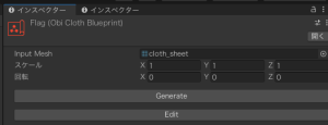

cannot edit blueprint in unity2020 - syunteri - 22-11-2022 unity ver 2020.3.41f1 cannot edit blueprint in unity2020 The scene is blank and I get the error message below RE: cannot edit blueprint in unity2020 - josemendez - 22-11-2022 (22-11-2022, 05:55 AM)syunteri Wrote: unity ver 2020.3.41f1 Hi, Reset Unity's editor layout. This is a bug in Unity's immediate mode GUI that has been present for quite some Unity versions now, go to Window->Layouts->Reset all layouts and that should fix it. RE: cannot edit blueprint in unity2020 - syunteri - 22-11-2022 I see. It was saved because I could not see it suddenly and could not improve it. Thank you very much. |
