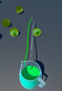

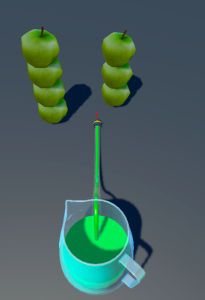

Liquid inside the rope. How to do this? - Vincent'sFriend - 11-10-2022
Hello everyone!
I am going to create transparent rope with liquid inside
https://play.google.com/store/apps/details?id=pigment.collect.sort.tangle.puzzle.game
Which way is the best for this?
1. I tried to do second rope which was thinner than first and put it inside, but their behaviors are different
2. Maybe I should buy special shader? https://assetstore.unity.com/packages/vfx/shaders/liquid-shader-urp-lwrp-202713

A shader is definitely the way to go for this. I can't be 100% sure that the liquid shader you linked to will work well with ropes, but as long as it supports arbitrary meshes and not just closed/convex ones it should do the trick.
