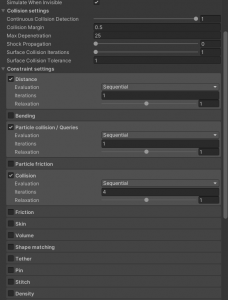

[attachment=1446]Hello,
In more than one rope, it is not seen which ropes are in contact with each other. I have multiple ropes under the one solver.
Rope1 and Rope2 colliding but , Pa and Pb gives same Rope(Rope 1) , same blueprint ( not saying other interacted rope) . but it doesn't say which of the two interacting rope is which. how can i learn each of the collided rope

You'll find the answer in the manual, in the "Retrieving the actor involved in a contact" section of "Scripting collisions":
http://obi.virtualmethodstudio.com/manual/6.3/scriptingcollisions.html
Quote:The ParticleInActor struct has two public variables:
Actor: A reference to the ObiActor to which this particle belongs. //<--- this is what you need
IndexInActor: The index of this particle in the actor's arrays.
So you can just access pa and pb's actor property to get a reference to the ropes. For instance:
Quote:ObiSolver.ParticleInActor pa = solver.particleToActor[particleIndex];
ObiSolver.ParticleInActor pb = solver.particleToActor[particleIndex];
ObiRope ropeA = pa.actor as ObiRope;
ObiRope ropeB = pb.actor as ObiRope;
if (ropeA == ropeB)
  // self-collision
else
  // inter-collision

Okay thank you Sonrisa . It's worked
