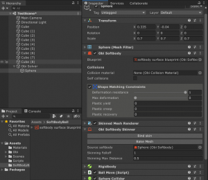

Hi, I have Ball(sphere) and it has soft body property. I want to click and drag with the mouse.
Problem: it breaks down when it moves.

Why does your code change the velocity/gravity of a rigidbody?
An object can either be a softbody or a rigidbody. It makes no sense whatsoever to add a rigidbody component to a softbody.
A softbody in Obi is made of particles, which are like tiny individual rigidbodies. If you want to drag a softbody, pick one of its particles and move it.
Obi already provides a helper component that does this: ObiParticleDragger. You can just use it.

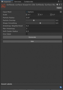

How can I fix the nested migrations issue?
I use the standard obi soft body ball.
when I put a ball on top of a ball a few times, it intertwines.
RE: drag the ball - josemendez - 02-11-2021
(02-11-2021, 12:16 PM)0hsyn1 Wrote: Hi,
Just make sure your particles are large enough that no/few gaps appear in between them, then use enough collision constraint iterations/substeps.
