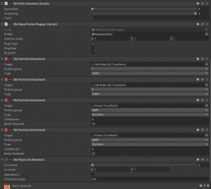

Magnitude other Rigidbody - xkalibrx - 28-04-2021 Hi guys. I can't find a setting for the rope to act on a physical object. The task is as follows. It is necessary for the rope to reduce the speed of movement of the directed physical object. So that when it is fully stretched. stopped the object completely. Rope does not interact with the speed of the physical object at all. And so rope fully pulled, it just goes through it. Moving the object itself through the rigid body in a fixed update. Where to dig, please help. RE: Magnitude other Rigidbody - josemendez - 28-04-2021 Hi! First of all make sure the object is a rigidbody, and that it's being translated due to its own velocity (that you can modify by applying forces, impulses, accelerations, etc). If the object is moved by directly setting its transform position, there's nothing Obi (or other objects) can do to stop it, as you're forcing it to be in a certain position no matter what. Once you're sure that's ok, you want to look into mass. The mass ratio between objects determines how they react to a collision: the heavier object will displace the lighter object. In Obi you can set mass on a per-control point basis, using the path editor. See: http://obi.virtualmethodstudio.com/tutorials/ropesetup.html Quote:Moving the object itself through the rigid body in a fixed update. This bit makes no sense whatsoever. What do you mean by moving the object trough a rigidbody? The object either is a rigidbody or it isn't, not sure what you mean by that. Maybe you mean you’re using rigidbody.MovePosition()? In that case, see above: you can’t set the position directly if you want the rope to be able to react to it. RE: Magnitude other Rigidbody - xkalibrx - 29-04-2021 (28-04-2021, 03:04 PM)josemendez Wrote: Hi!An object moving on a rope has a rigidbody. The rope simply does not slow down the object in any way, as if it is moving through the position Judging by the description, only Dynamic attachments can interact with another body. But even with the setting of dynamic points, the ball flying on the rope does not change its speed in any way during collision. RE: Magnitude other Rigidbody - josemendez - 29-04-2021 (29-04-2021, 05:25 AM)xkalibrx Wrote: An object moving on a rope has a rigidbody. Your rigidbody is kinematic for particles. Kinematic rigidbodies have infinite mass, so particles won't be able to affect their velocity. Just disable the "kinematic for particles" checkbox in your ObiRigidbody component. (29-04-2021, 05:25 AM)xkalibrx Wrote: Judging by the description, only Dynamic attachments can interact with another body. But even with the setting of dynamic points, the ball flying on the rope does not change its speed in any way during collision. Obi supports full two-way coupling with rigidbodies both for attachments and collisions. See the "rigidbodies" section in the collisions page of the manual: http://obi.virtualmethodstudio.com/tutorials/collisions.html Quote:Rigidbodies RE: Magnitude other Rigidbody - xkalibrx - 29-04-2021 (29-04-2021, 07:33 AM)josemendez Wrote: Your rigidbody is kinematic for particles. Kinematic rigidbodies have infinite mass, so particles won't be able to affect their velocity. It was so close ... Thank you so much!!!! RE: Magnitude other Rigidbody - josemendez - 29-04-2021 (29-04-2021, 07:45 AM)xkalibrx Wrote: It was so close ... You're welcome! ![]() |
