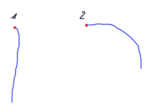

I want it to stay as straight as it can, as if i was holding a sheet of paper by the side :
[attachment=821]
On this example, the band of the left bends a lot. It's the current way the simulation works. I'd like it to act more like the example on the right.
So this si mainly a bending problem. I also have question about the way the forces are calculated, because I'd like to simulate a traction sensor, and i need to get the force applied by the band on a cylinder for example.

RE: Long Metal Sheet Simulation - josemendez - 02-12-2020
Bending is controlled by bending constraints: http://obi.virtualmethodstudio.com/tutorials/bendingconstraints.html
Assuming you haven't deactivated them (they should be enabled in your case), expending more iterations on them will allow the solver to reach higher bending stiffnesses. Also, using more substeps will noticeable improve simulation quality (which means higher stiffness will be easily achieved).
If you haven't already, take a look at this page: it describes in detail the way simulation works and how iterations/substeps affect its quality:
http://obi.virtualmethodstudio.com/tutorials/convergence.html
