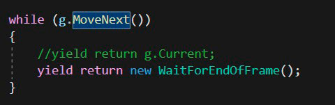

Analyzing more in detail the method "Generate()", we have realized that the method "g.MoveNext()", located in line 300 of the class "ObiActorBlueprint", is the one that causes the problem, however this is a closed method.
[Image: 3_3_duda.jpg]
Is there a way to perform this process in several small steps (or ideally in a Thread), so that the program does not have to stop several times while generating the 4 blueprints?

3) First and more importantly: you can't call any Unity API methods from outside the main thread, except for a few ones such as Debug.Log(). This is a basic limitation of Unity, and the reason why you can't generally use multithreading unless you're very careful.
Generate() is a coroutine, as evidenced by its return type: IEnumerator. As such, its purpose is to "spread" work over multiple frames so that the main thread is not blocked for too long. You can even show a progress bar if needed, this is what it's done in editor to inform the user of the generation progress. However you can't call a coroutine that uses the Unity API from a thread other than the main thread. Coroutines are designed to allow for easy concurrency without parallelism, so no need to use threads if all you need is concurrency. If you're unfamiliar with coroutines, see: https://docs.unity3d.com/Manual/Coroutines.html
The IEnumerator.MoveNext() method is an internal C# method. It's used to move to the next enumerator element. In the case of coroutines, it advances the coroutine until the next yield instruction. Calling MoveNext() in a loop basically ensures the coroutine is completed before continuing execution. If any exception happens before reaching the next yield (in this case, the exception is caused by a call to a Unity API method from outside the main thread), it will be thrown by MoveNext(). See: https://docs.microsoft.com/es-es/dotnet/api/system.collections.ienumerator.movenext?view=netcore-3.1
So in short, use coroutines as they're intended to be used Guiño:
yield return StartCoroutine(blueprint.Generate());
If you capture the return value of the coroutine and advance it yourself instead of yielding, you can do:
IEnumerator coroutine = blueprint.Generate();
CoroutineJob.ProgressInfo progressInfo;
do{
    if (!coroutine.MoveNext())
        progressInfo = null;
    else
        progressInfo = coroutine.Current as CoroutineJob.ProgressInfo;
        // write your own method to update or show a progress bar: userReadableInfo contains info about what the coroutine is currently doing,
        // progress is a float ranging from 0 to 1 that represent the percentage of completion.
    ShowProgressBar(progressInfo.userReadableInfo, progressInfo.progress);
}while (progressInfo != null);
