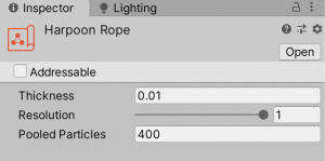

I'm trying to create a harpoon gun which is launched from a flying drone and hooks into whatever it collides with. The rope blueprint looks like this:
[attachment=727]
To shoot the harpoon, I'm starting with a very short rope, and increasing the length of the rope along with the velocity of the tip of my harpoon in FixedUpdate. The rope is attached to both the drone and the harpoon tip via ObiParticleAttachment.
