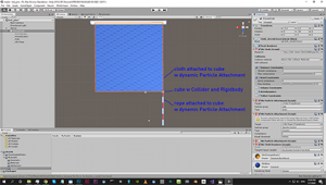

ObiCloth + ObiRope attached - Maria - 07-01-2020 I would like to have the ropes hanging from the cloth, forming the costume. The question is how to attach rope and cloth together and have them affecting/deforming each other. I saw your Soccer Goal video demonstrating similar principle, but I couldnt find any tutorial or sample scene for it. First I tried to attach Rope to Cloth directly using ObiParticleAttachment with Static type, but Unity crashed. Then I tried Dynamic type and got the following error "Dynamic attachments require the target objects to have a ObiCollider component. Either add one, or change the attachment type to Static." Therefore I tried a following workaround -selecting particles in ObiClothBlueprint where I want my rope to hang -attaching Cube to Cloth using Dynamic ObiParticleAttachment -attaching Cube to Rope using Dynamic ObiParticleAttachment again But I suspect I don't really need this intermediary (cube or other rigid body), or do I? What is a proper way to do this? Thank you |
