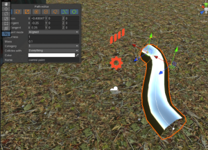

RE: Edit Path editor not showing - AntonioModer - 23-12-2019
@josemendez
Issue fixed.
helped me: reset the editor layout to any default layout.
Thank you

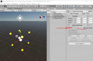

Moreover, in the same way I also solved the problem with editing Light Probe Group.
This is same problem, when after clicking on button "Edit Light Probes", LightProbes-editor not work.
This is Unity-bug: https://forum.unity.com/threads/cant-select-light-probes.716924/
Thank you. Sonrisa
[attachment=562]
